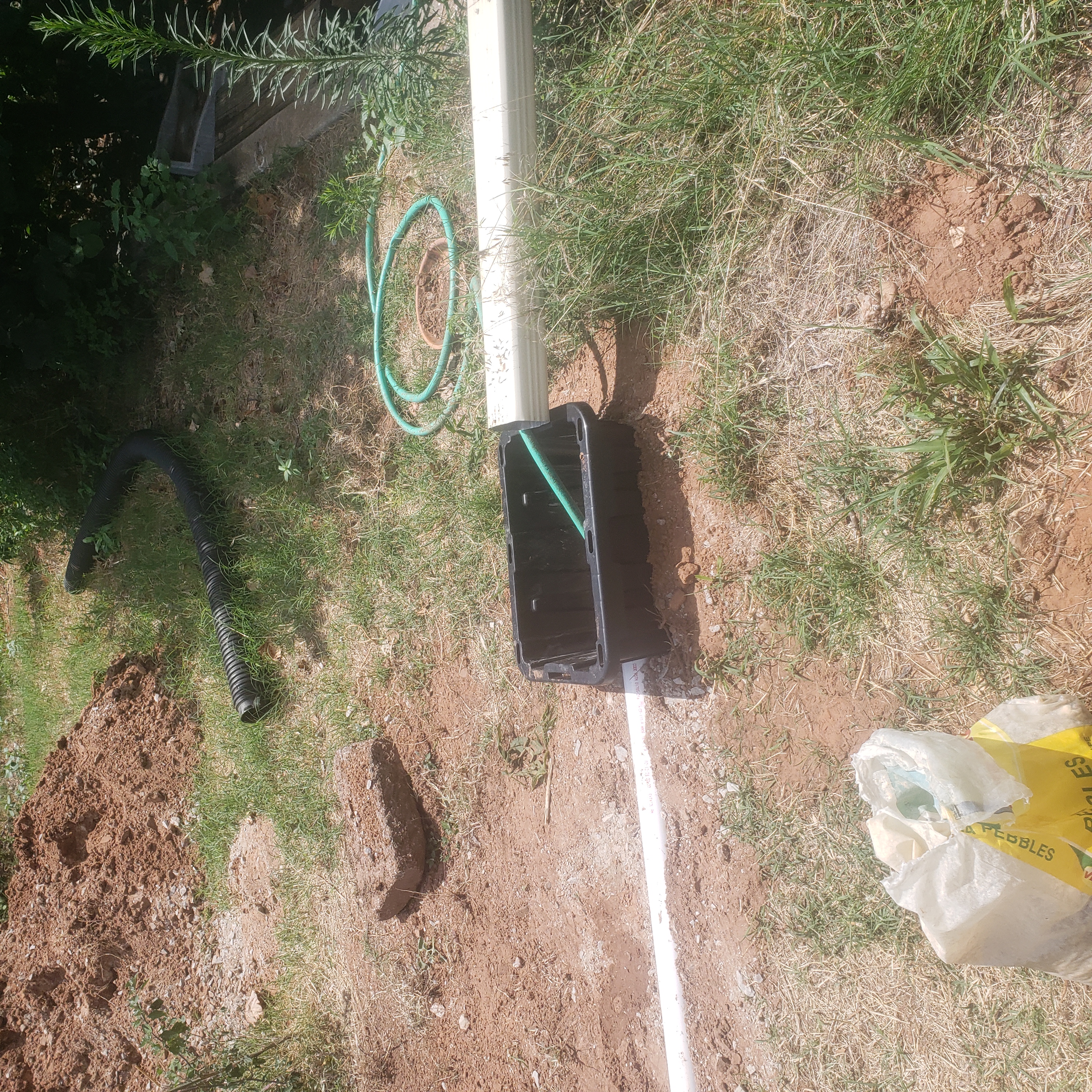

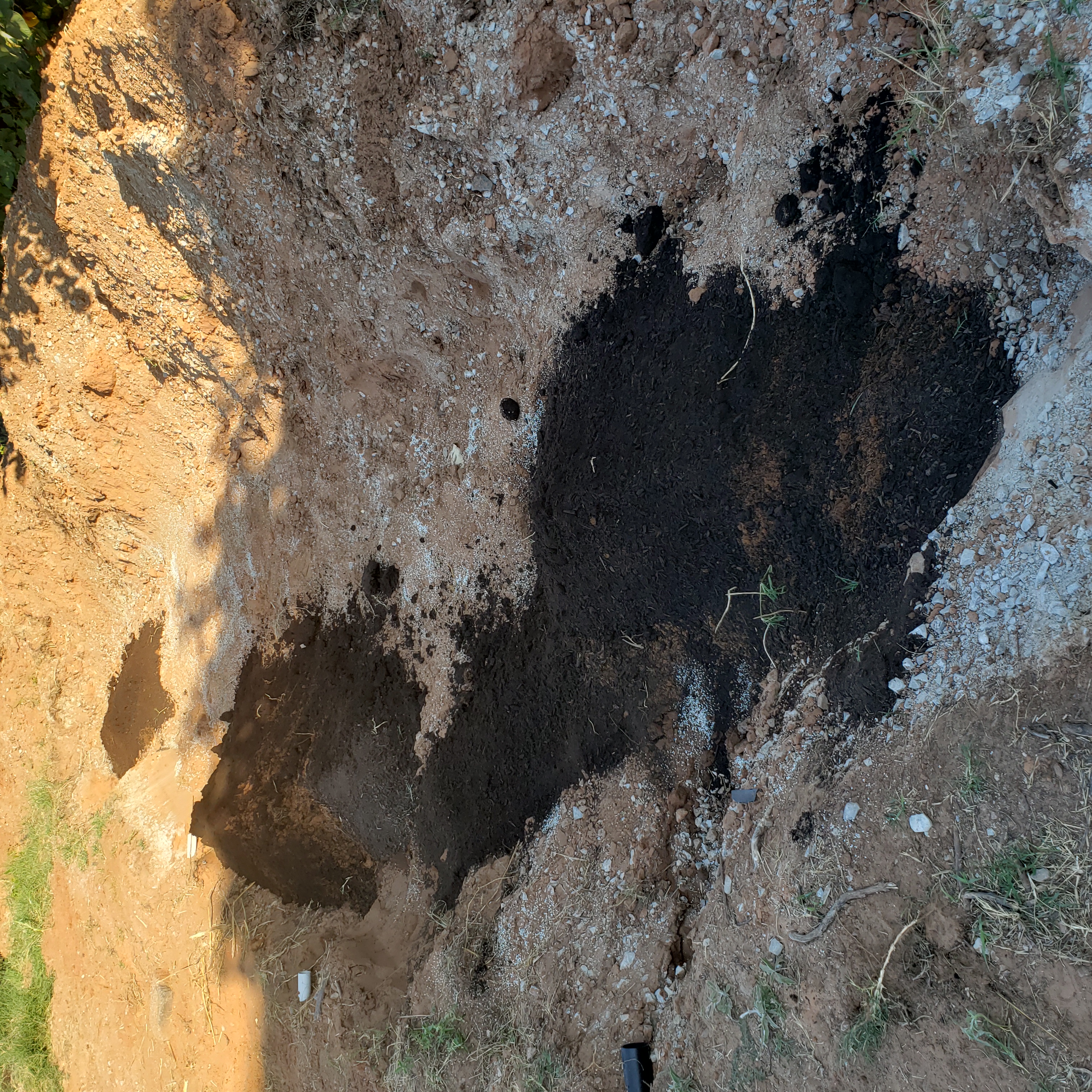

We dug this one near a downspout that was inconvenient for rainwater catchment. In future we will plum our kitchen sink and dishwasher water to it ( with a 3 way valve to turn it back to septic in freezing weather). This trench is 6 ft deep, 8 ft wide and 18 ft long. The bottom is lined with bentonite and a little compost.
