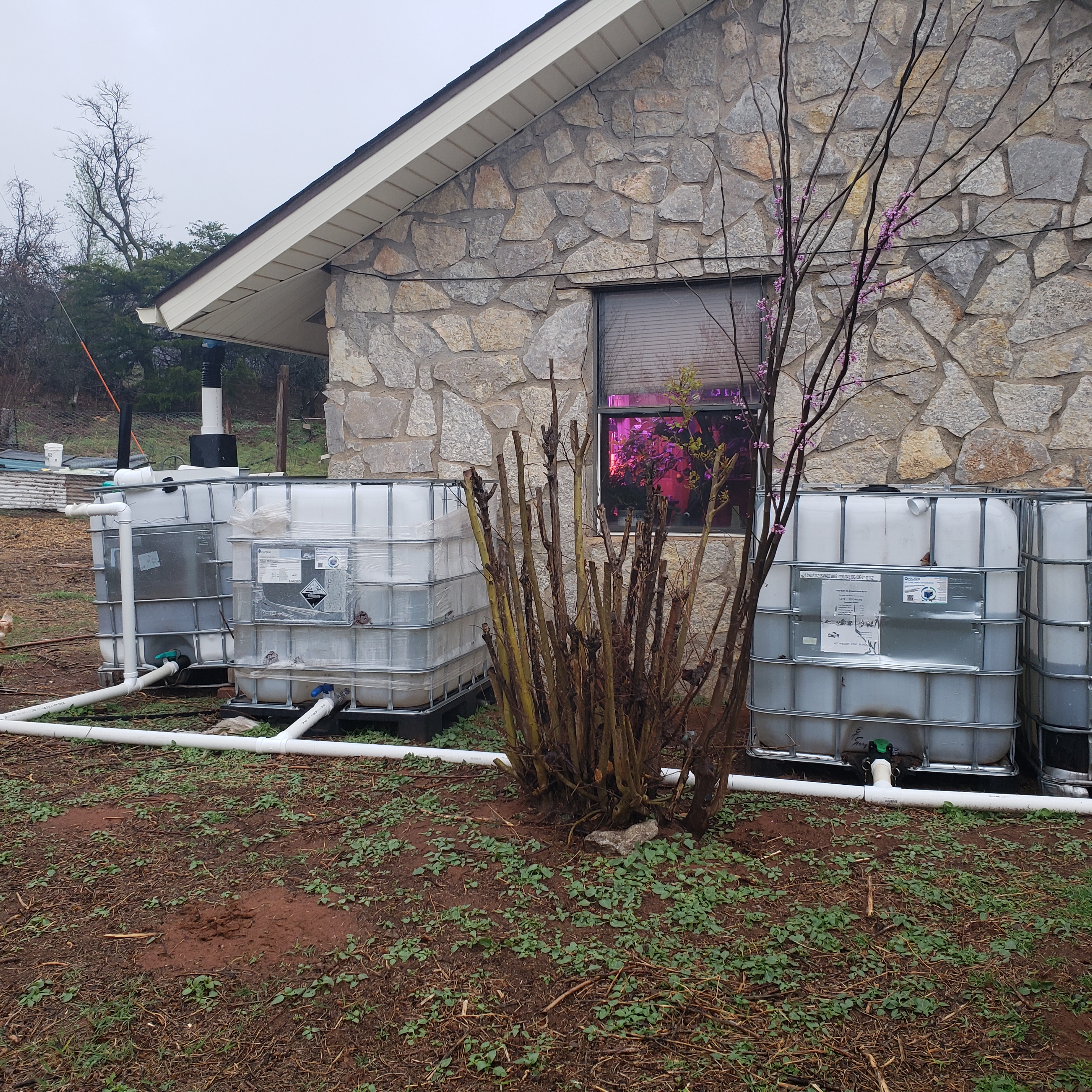

This is a tank battery. Used cheap it free IBC tanks at the downspouts and plumed together so they fill at the same rate. The math is sq foot of roof X inches of rain X .62= rain caught. Its important that your overflow/outlet can shed your heaviest historical rainfall or that it is the same size as you total inlets.
- Rooftop rain catchment
- 20240321_181255.jpg (4.38 MiB) Viewed 141 times

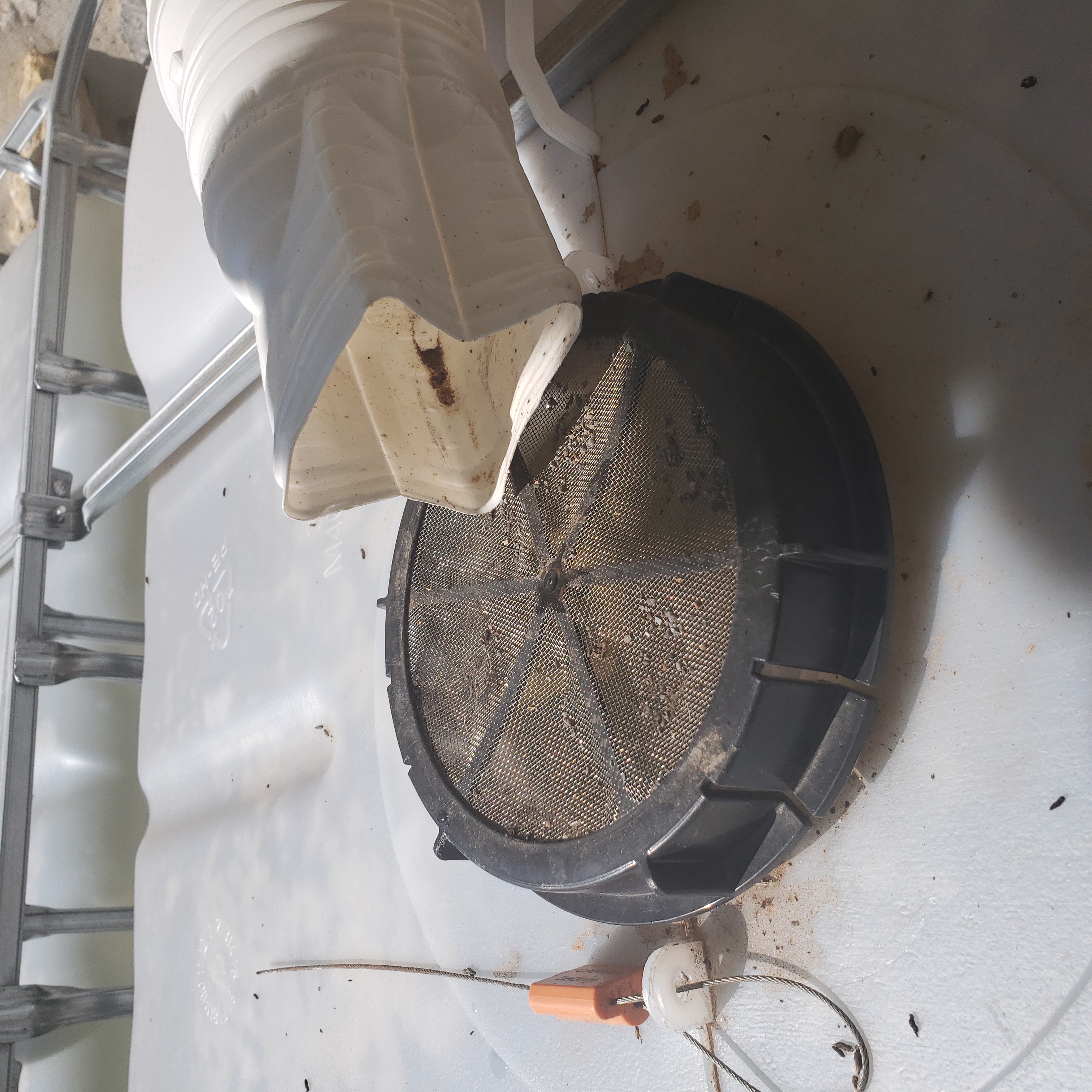

Minimal fliteration since this only irrigation water. Don't buy this. It sucks. Just get some plastic flower pots and sandwich window screen between. I add a leaf filter to the down spout as well.
- 20230723_162509.jpg (2.95 MiB) Viewed 140 times
