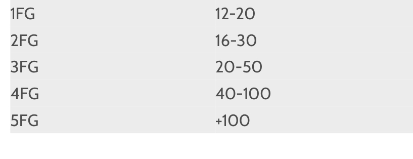

9. Separate by using the following mesh size picture will be attached. With everything smaller then what you need can be re-pressed again.

Data to use.

Data.

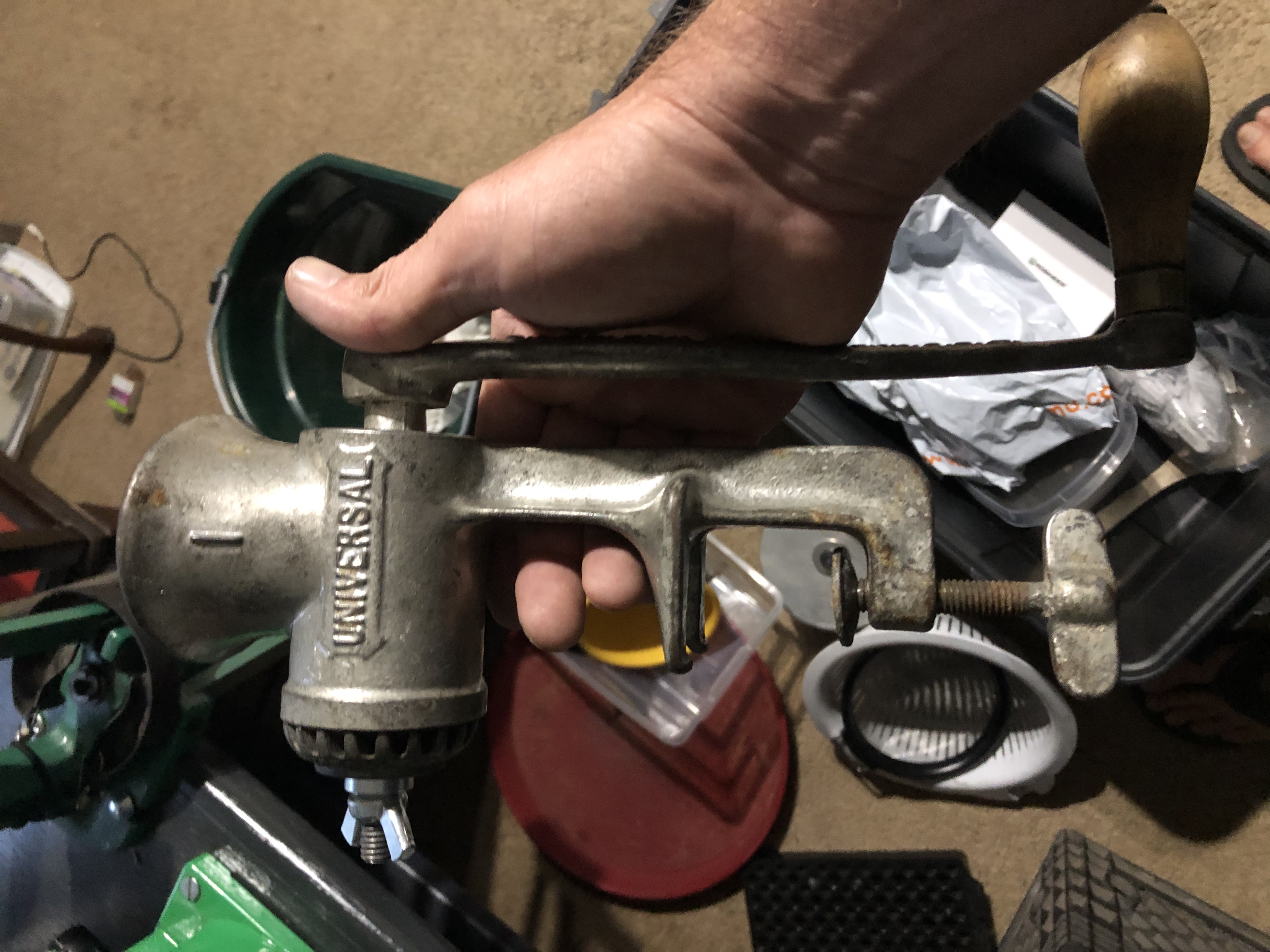

Grinder
- CAB9E54F-BA88-4498-BC78-54559441DF7D.jpeg (2.65 MiB) Viewed 664 times
Re: Making black powder
Charcoal grinder with crumbled attachment.
- C569971C-E73A-45B3-9E04-72CB2243378E.jpeg (2.65 MiB) Viewed 664 times
