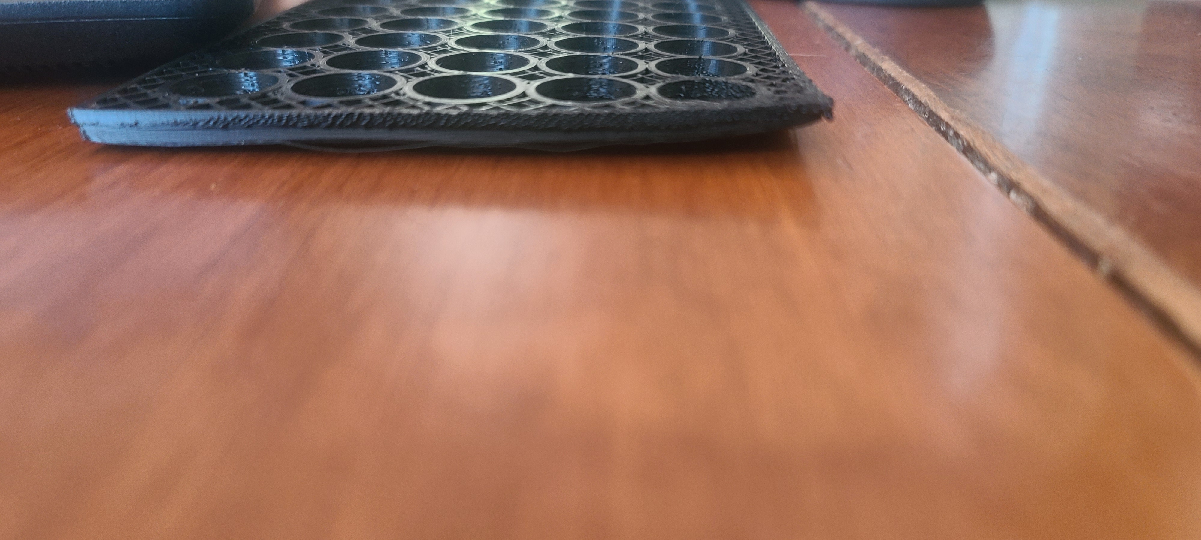

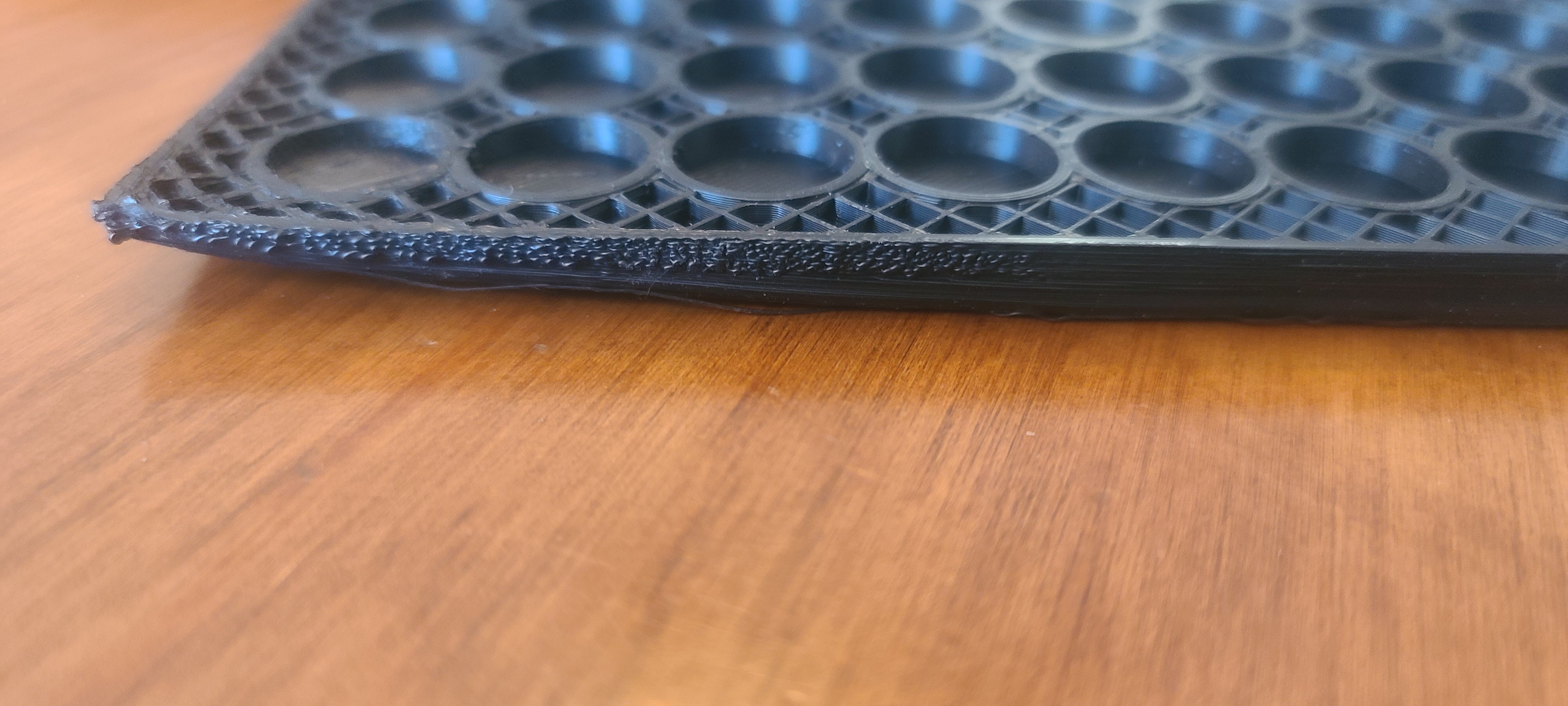

Why are corners pulling up? Pei plate, glue stick, filament dried 12 hours prior. 65°C bed, 215°c nozzle.

2 issues cause this. Either a draft in the room where your printing or your part is cooling to quickly. Adjust your fan speed settings in the slicer down. A cheater way to deal with it is print with a brim or mouse ear brim to help keep the corners down. Had this problem with the V3SE when I first got it and found that the cooling was the issue. As the part cools it pulls up on the lower layers causing your issue.
Posts: 1104
Re: Pulling up
Good to know. It is on an Ender 5 V2, with enclosure, but when printing it is at top, so will try an over-all machine to cut out drafts completely.
Re: Pulling up
Agree with his comment on cooling.
